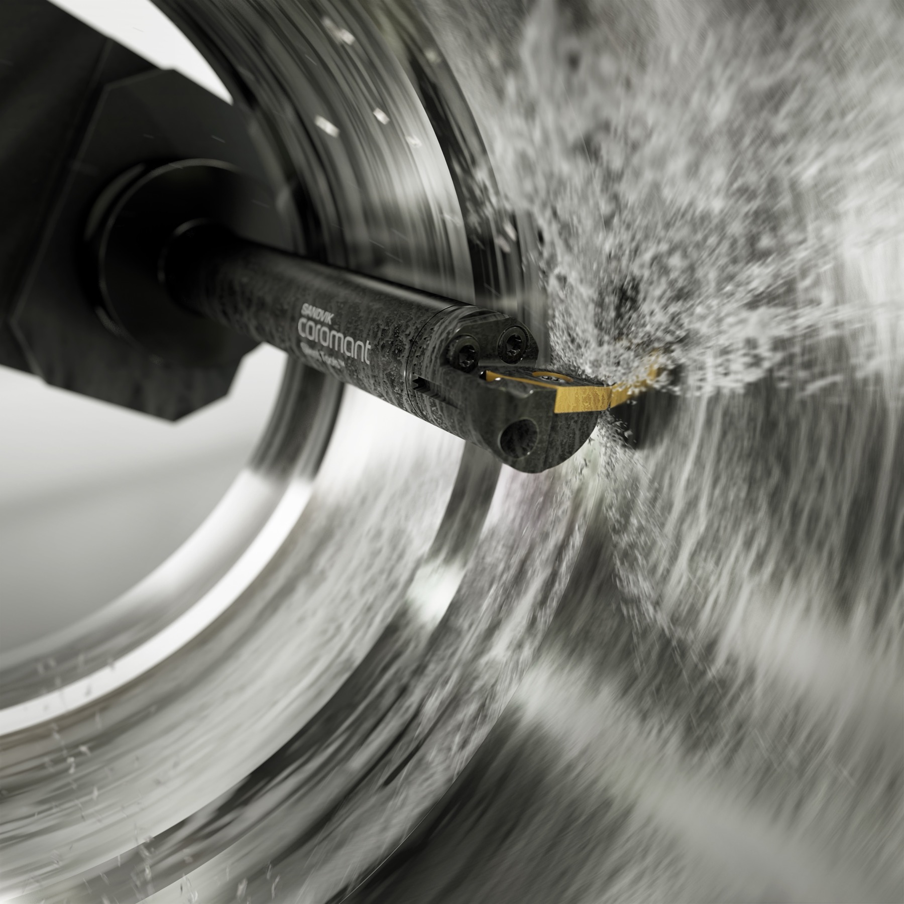

Sandvik Coromant Silent Tools boring operation
Modern boring systems use damping and process feedback to control vibration. Credit: Sandvik Coromant

Extending sometimes deep into a hole of varying diameters, boring by its very nature is susceptible to chatter and vibration, the archenemies of the process. Vibration and tool deflection ruin surface finishes, increase tool wear and produce a dimensional inaccuracy that can compromise the process.
“Chatter, vibration, not meeting tolerance requirements and having to recut the bore multiple times to get it within tolerance, these are all time-killers in production,” said Brent Godfrey, industry and applications specialist for Sandvik Coromant.
To combat chatter, advanced damped boring bars use an internally tuned mass damper to cut vibration for improved surface finish and tolerances. Operators can also run higher speeds and feeds without creating tool resonance, boosting productivity and throughput. Additionally, damped bars absorb kinetic shock, which helps insulate the machine spindle from wear and damage.
Passive damping boring tool systems, such as Sandvik Coromant’s Silent Tools line, include sensors near the cutting point to help operators improve quality and performance. The sensors feed temperature, vibration and deflection data back to an operator’s screen or tablet, allowing the operator to adjust cutting parameters in real time.

Caption: Advanced damped boring bars use an internally tuned mass damper to cut vibration and chatter for improved surface finish and tolerances, especially in applications that require long overhangs.
