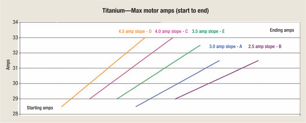

Figure 1: The fluids were compared using maximum amp load as recorded by the machine tool control. The graph shows the motor amps increased during the course of the machining process for each fluid. A smaller slope indicates longer tool life, and fluids A and B had the smallest slopes.

How can you evaluate coolant to measure its effectiveness with respect to tool life and cycle optimization? According to Milton Hoff, vice president of strategic technology development for Master Chemical Corp., Perrysburg, Ohio, one way is to measure spindle motor load. “Spindle motor load can be monitored most effectively through measurement of the current change during a cut,” he said. “Most machine tool controllers can monitor the maximum amp load during a standardized pass or cut. If a machine doesn’t, you can set up a stand-alone ammeter to measure the change in current draw during a machining step.”
With either method, the starting current and maximum current need to be recorded.

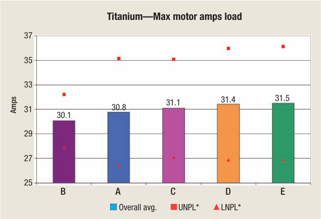

Figure 2: This graph shows the average maximum motor amps recorded during all of the passes, with upper and lower natural process limits* for each shown in red. A lower average and tighter natural process limits imply, or predict, longer tool life. Fluids A and B performed the best.

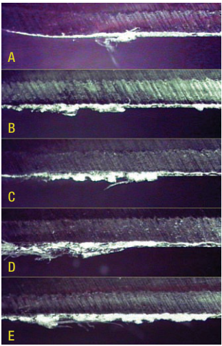

After each run, BUE was measured and 139 pictures were taken using an OGP optical comparator. Of the four cutting edges, the edge with the most BUE is shown after the 26th and final cutting pass for each fluid. The last picture taken after running tool two with cutting fluids A through E is shown above.

Running the parameters previously described, the expected tool life was 3 hours. The tools were examined microscopically with an OGP optical comparator, built-up edge was measured and photographs were taken. This happened after about every 30 minutes of cutting time, once a tool completed a pass through the material block to avoid workhardening. Readings of the machine spindle amp-load meter were also documented.

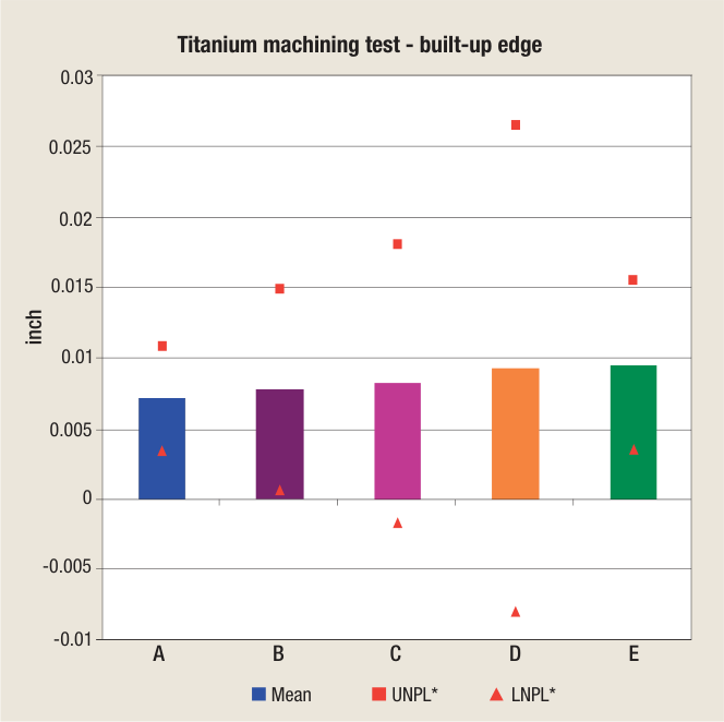

Figure 3: Tool life is also predicted by measuring the largest amount of BUE found on any of the four cutting edges after a set number of passes are completed. This graph shows that fluids A and B had the lowest overall average BUE and the tightest natural upper and lower process limits*, indicating the longest tool life.
The fluids were compared using maximum amp load as recorded by the machine tool controller. The motor amps increased during the course of the machining process. The average maximum motor amps were recorded during all of the passes, with the upper and lower natural process limits documented. Lower average and tighter natural process limits the implied, or predicted, longer tool life (Figures 1 and 2).
Tool life was also predicted by measuring the largest amount of BUE found on any of the four cutting edges after completion of a set number of passes. That’s because a tool with more BUE will be duller and therefore have a shorter life. Fluids A and B recorded the lowest overall average BUE and the tightest natural process limits, indicating the longest tool life (Figure 3).
