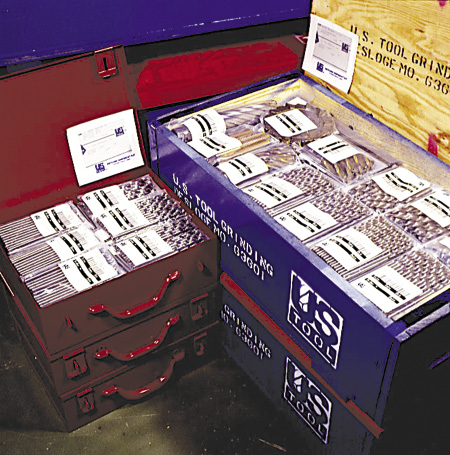

Customers send in boxes of dull tools (above and below) and US Tool, after determining what is economical to resharpen and what is not, resharpens and packages them to be sent back. Customers ship from 30 lbs. up to 3,000 lbs. of tools per week to US Tool.

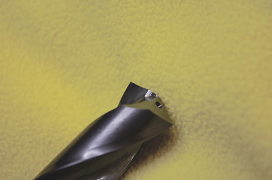

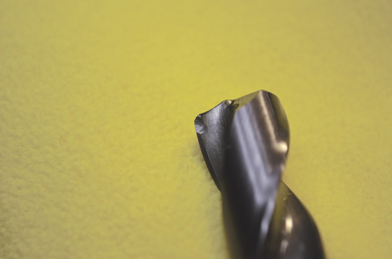

STI%20DSC_0337.tif
Courtesy of Specialty Tools
Before (above) and after (below) images show a worn solid-carbide drill resharpened by Specialty Tools.
STI%20DSC_0341.tif

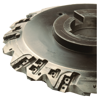

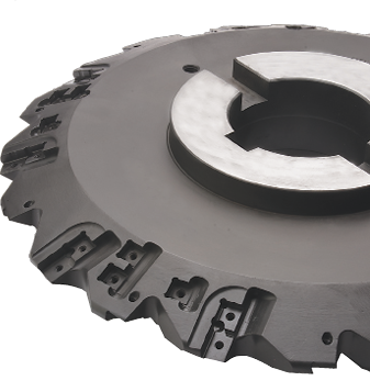

CTS%20revised%20damaged%20cutter.tif
CTS%20Gear%20Cutter%20After%20Picture%20v2.tif
Courtesy of Carbide Tool Services
Before (top) and after (above) images show a worn indexable gear cutter repaired by Carbide Tool Services.
