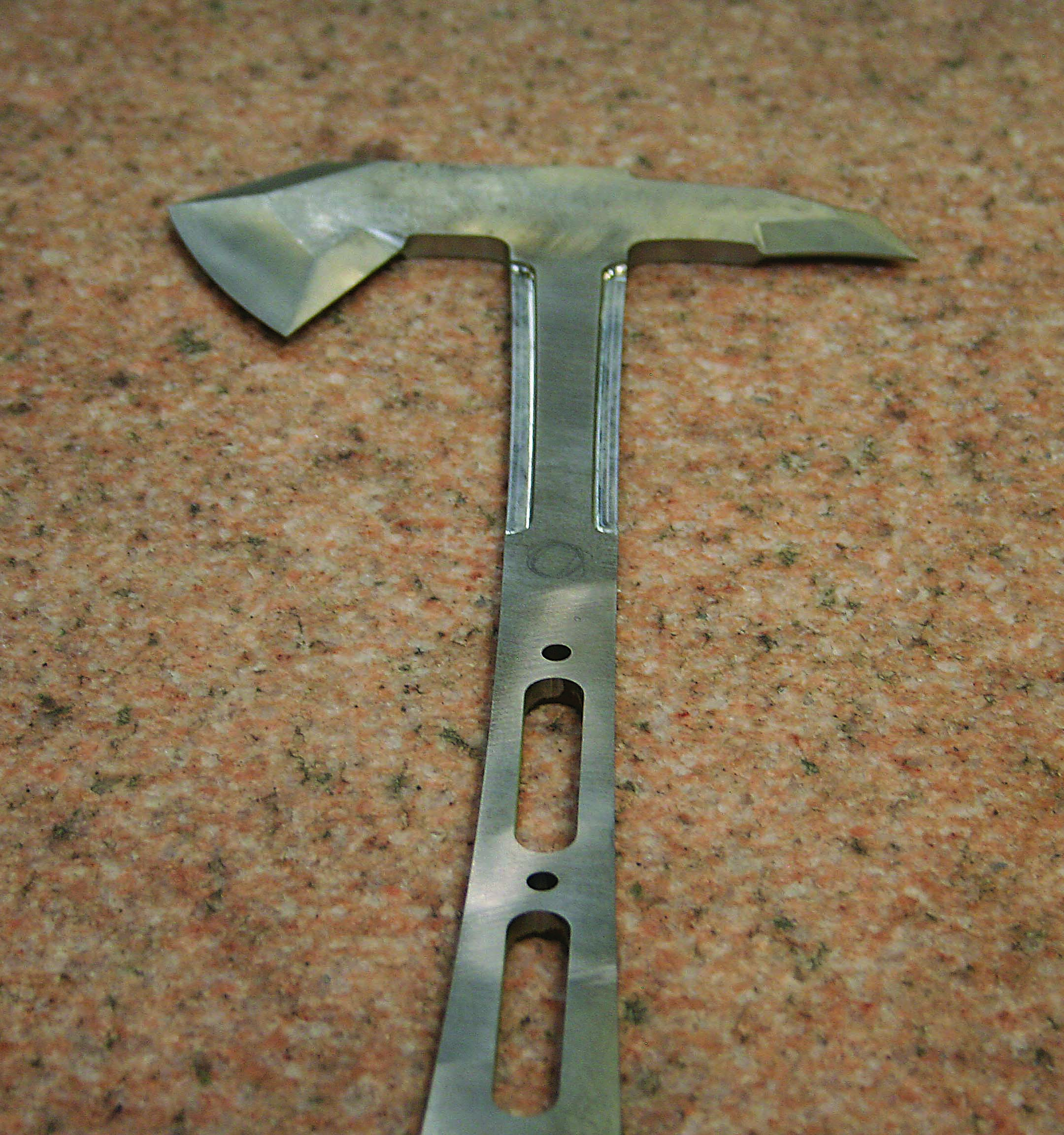

However, machining a knife blade with sculptured surfacing is a more complex job than producing, say, a buttstock for a firearm, according to Tom Vagasky, CNC programmer for DoubleStar. For example, the company’s new Wrath edged weapon has six distinct surfaces, each of which subtly bevels into the next so the surfaces nearly blend together.

DoubleStar says its Wrath tomahawk edged weapon, shown without its textured handle, can hack through a car’s A-pillar.
