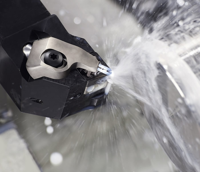

Application of coolant directly to the cutting edge is important for heat management, chip evacuation and surface finish. Image courtesy Seco Tools.

“You absolutely have to figure out a way to disperse heat,” said Scott Leitch, sales and marketing manager at Exsys Tool Inc., San Antonio, Fla. “If the toolholder doesn’t have coolant either running through it or running on top of the assembly while it’s in operation, heat will build up and can have negative effects on tool life, surface finish and part quality.” Leitch added that sealed toolholders (for the application of through-tool coolant) help the coolant disperse heat more efficiently.
Kurt Ludeking, product manager at Walter USA LLC, Waukesha, Wis., noted most machines are supplied with coolant ports and, in theory, operators just need to direct the coolant to the cutting edge for proper heat
removal.
“That works … sometimes,” he said. “It depends on a lot of things, and the coolant flow can get misaligned during routine maintenance, or even knocked out of the way by chips flying around. If you don’t have the coolant directed properly, it won’t be effective and you’ll wind up getting a lot of crater wear and flank wear.”

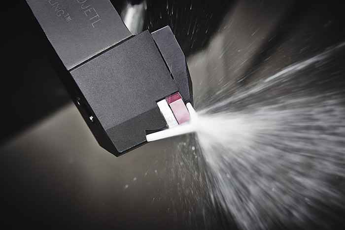

High-pressure through-coolant is typically regarded as the best solution, but it’s not always an option, such as when clearances don’t allow for a bulky high-pressure apparatus, or when the part is too thin or delicate to withstand the pressure.
Absent high-pressure coolant, using toolholders that direct the coolant through the toolholder and straight to the cutting edge helps, Ludeking said. “Even if it’s relatively low pressure, around 150 psi or so, which is pretty typical for most modern machines, you get a better cooling effect, because it’s always directed right at the cutting edge.”

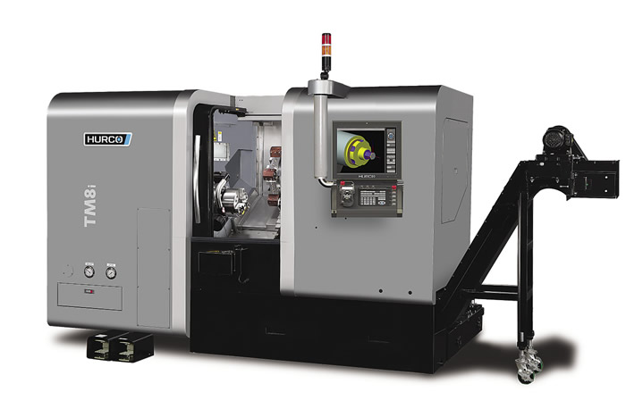

Hurco’s TMi series CNC lathes are for universal turning applications and offer an uncomplicated transition from manual numerically controlled turning, according to the company. Image courtesy Hurco North America.

Once the tool and the part are held in place, said Michael Cope, product technical specialist at Indianapolis-based machine tool builder Hurco North America, the next essential step is choosing the proper insert geometry.
“Insert selection can sometimes go beyond the typical decision between corner radius and the grade of a particular insert,” he noted. “For more-complex operations than simple facing and shoulder turning, picking the right insert geometry is a key component. Increasing the lead angle of the cutter can also help. Higher lead angles and positive-raked inserts produce a better surface finish than tools with a shallower cutting angle.”

Precision coolant toolholders provide coolant as close and horizontal as possible to the effective working area under the chip, benefitting chip control and tool life and increasing speed. Image courtesy Walter USA.
