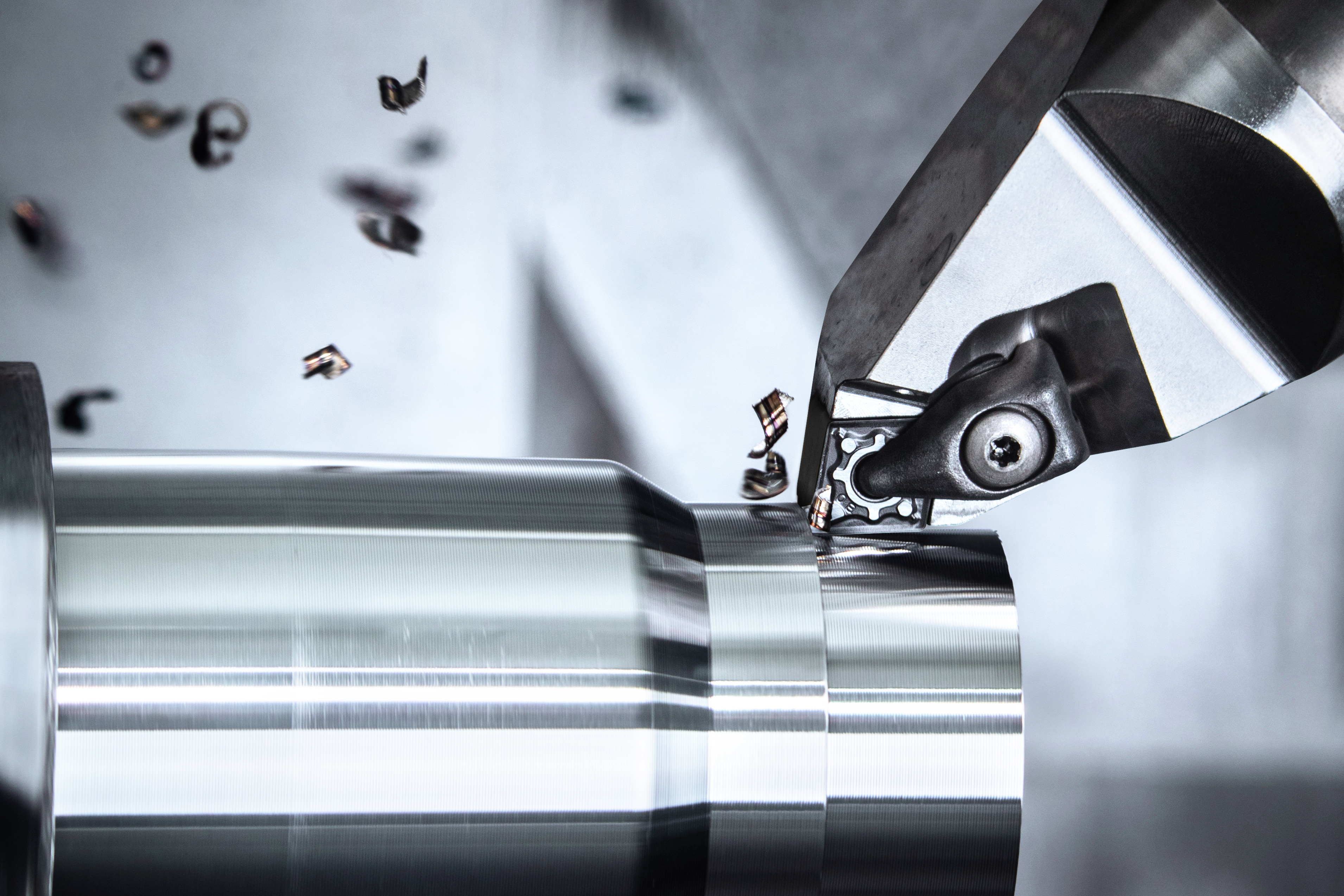

Ceratizit turning tool in action
Based on current market observations, price increases of around 10 to 15% for carbide inserts serve as a rough orientation, according to Ceratizit USA. Credit: Ceratizit USA

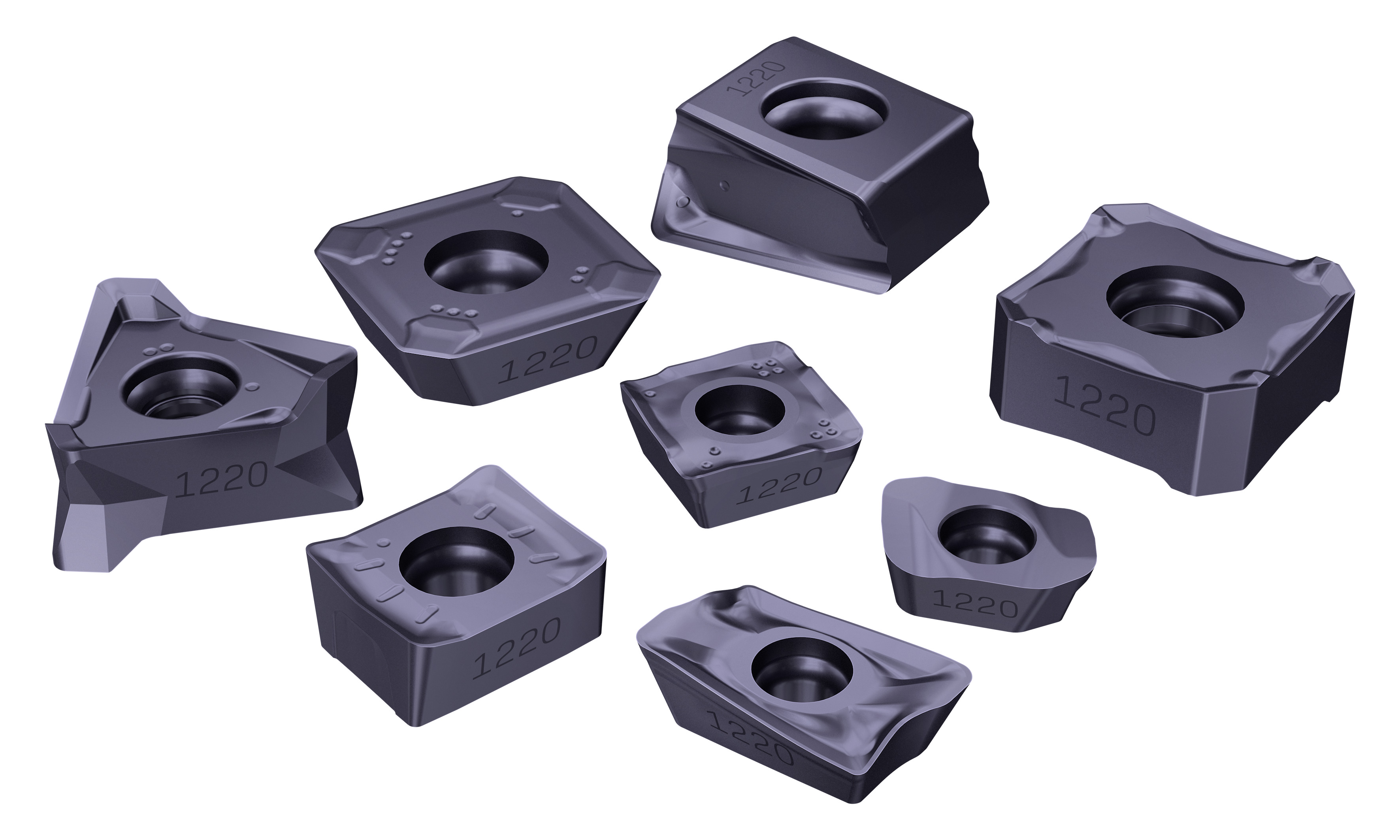

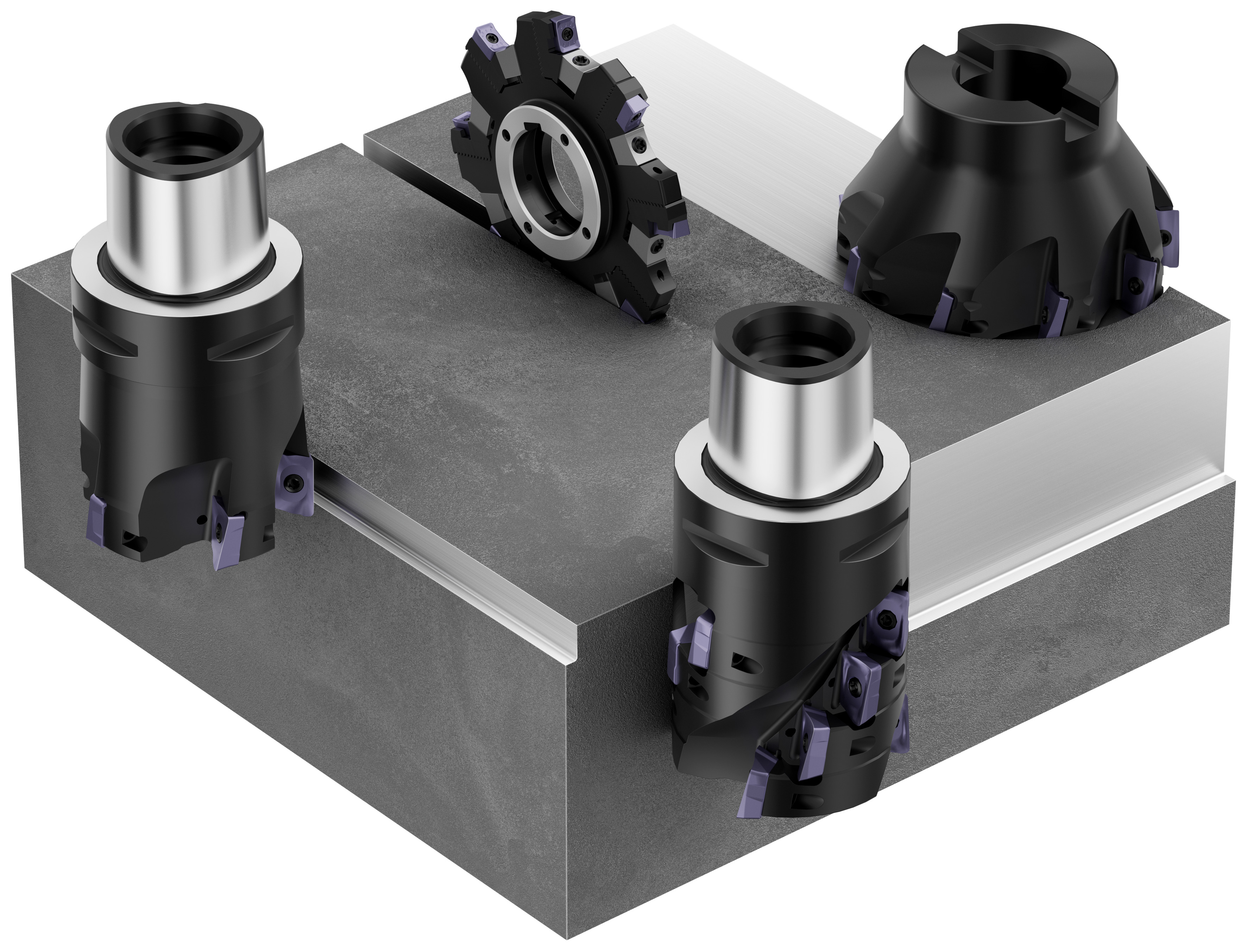

Milling Cast Iron
To boost throughput when milling cast iron, Sandvik Coromant Co. in Mebane, North Carolina, introduced the GC1220 indexable insert milling grade for light roughing to finishing cast iron. The grade is available in multiple geometries for dry milling and wet milling. Martin Hobbs, product specialist for holemaking and indexable milling tools, said because milling cast iron produces a lot of dust, many customers prefer running with coolant to help control the dust, especially when automation is involved. “They need to keep the chips off of the component when robots are going in and picking up and handling parts.”
GC1220 indexable insert in a milling application
Sandvik Coromant designs indexable inserts for a host of machining applications. Credit: Sandvik Coromant
In addition, GC1220 inserts are available with E, or ground, inserts and M, or pressed, inserts, as well as S, L, M and H geometries for sharp, light, medium and heavy. He added that a number determines the edge prep, with a lower number being sharper and a higher number being a heavier edge prep. A light hone is suitable for finishing applications and damping when there is a tendency for vibration and harmonics.

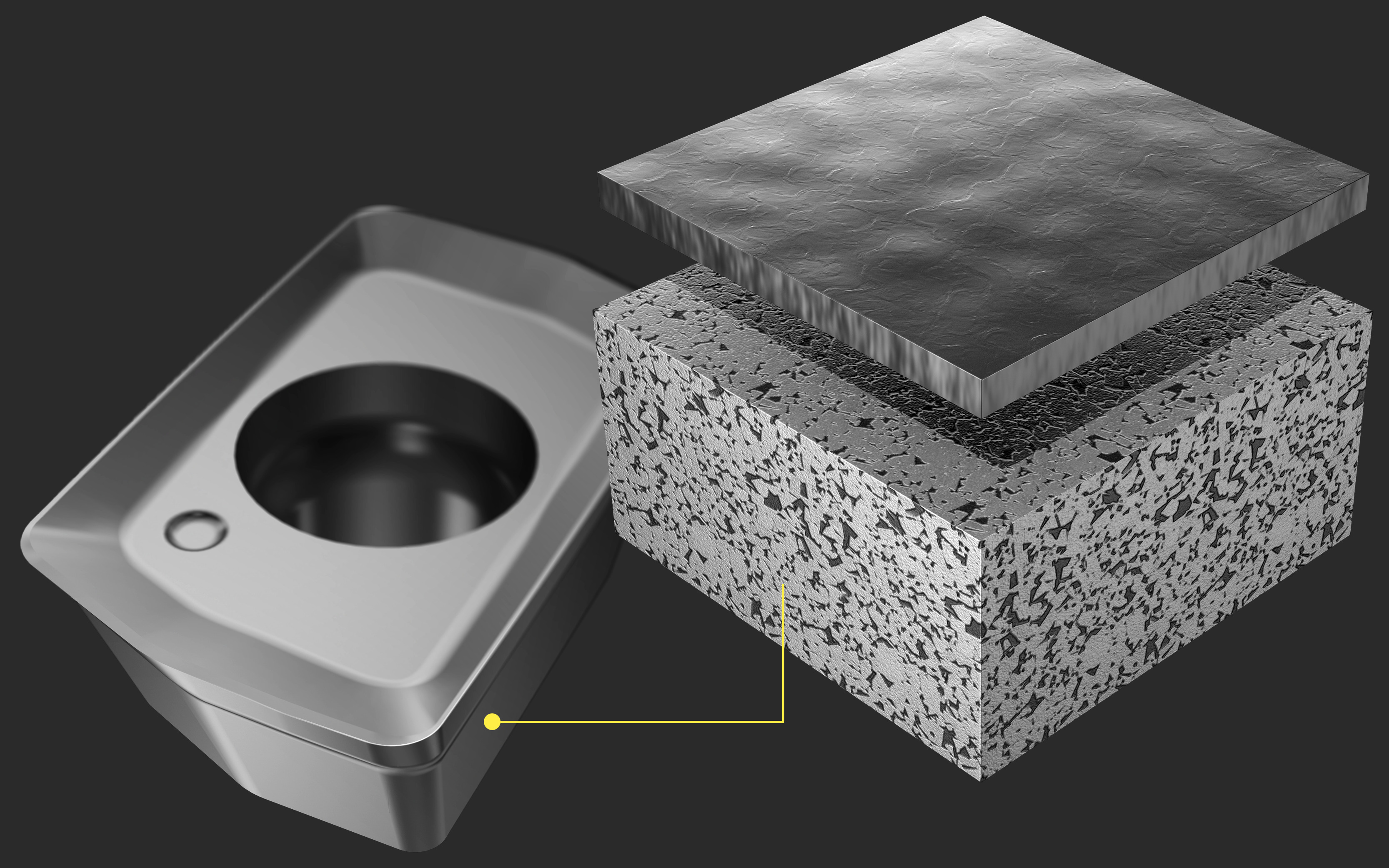

The GC1220 coated inserts have a multilayer with two different layers to provide twice the strength, Hobbs explained. “What’s unique about these coatings is the way that we use Zertivo technology to stand the atoms of these coatings on end, side by side and compressed tightly together in alignment with one another. They’re stacked together like the fibers of wood would be a board and in doing so it gives us much better predictability in tool life, extends tool life and gives us better wear resistance.”
Illustration of Sandvik Coromant Zertivo coating technology
Sandvik Coromant’s Zertivo technology stands the atoms of PVD coatings on end, side by side and compressed tightly together in alignment with one another to extend tool life and improve wear resistance. Credit: Sandvik Coromant
Depending on the workpiece material, the toolmaker offers uncoated variations. For example, an uncoated insert might be appropriate for milling gray cast iron, which generates powdery, fine chips, he noted. Because it is easier to cut than other types of cast iron, an insert for milling gray cast iron doesn’t require much in the way of geometric features. “We don’t necessarily need chipbreakers as much for gray cast, and flat top geometries can be very advantageous.”
Sandvik Coromant GC1220 insert collection
Sandvik Coromant introduced the GC1220 indexable insert milling grade for light roughing to finishing cast iron. Credit: Sandvik Coromant
Geometries are helpful, however, when milling the other varieties, Hobbs added, with gray followed by nodular with its compacted graphite nodules and then austempered, depending on the temperament. “And if we get into chilled white irons when we’re talking north of 60 Rockwell, it becomes even more difficult for us to cut those types of materials.”

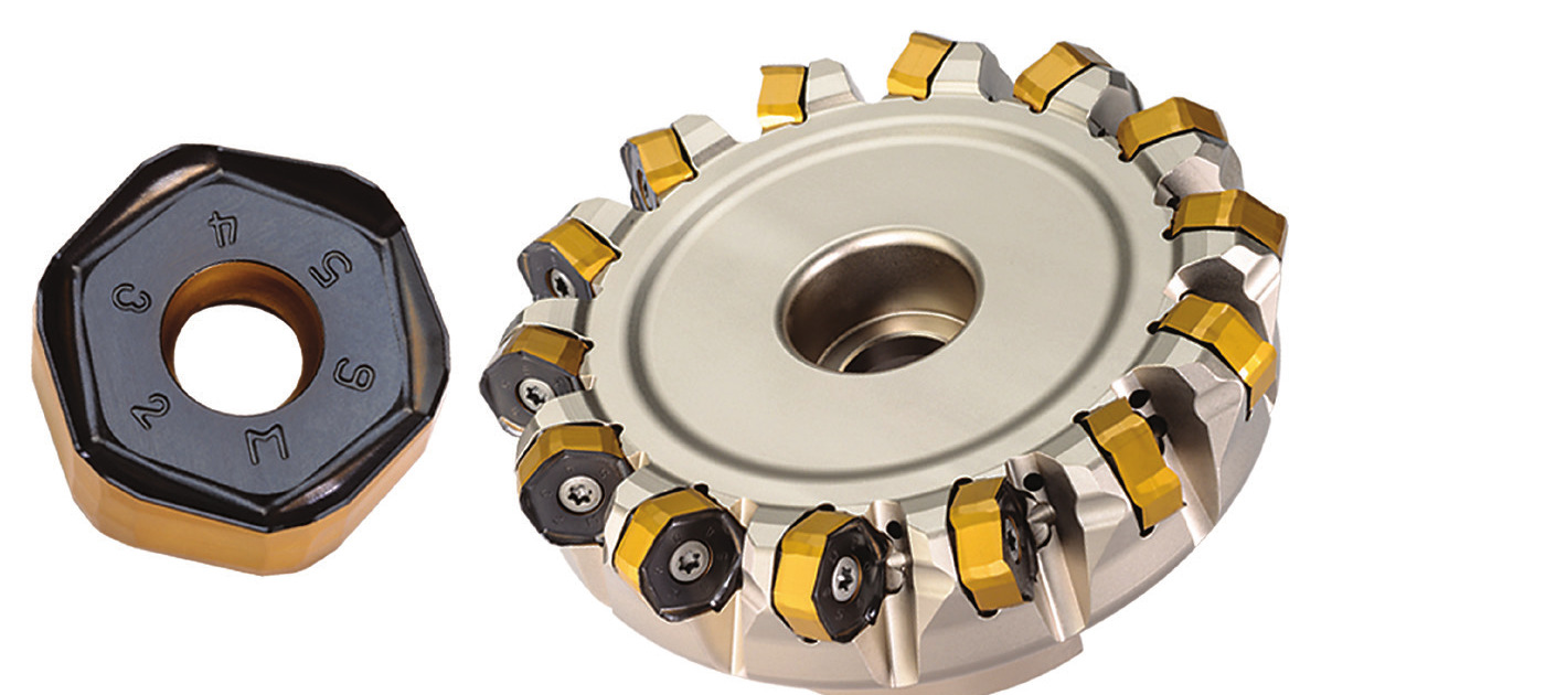

Another cost-control technology is the company’s DiPos, or two sided, technology, Dieken explained, doubling the number of edges compared to a single-sided insert while minimizing the amount of face grinding. “We can actually press all of what I call ‘sexy rake face geometry’ into a shape, and we can do it on two sides and have the seating pads held in place without grinding to be able to hold the tolerances that we need to.”
Ingersoll Cutting Tools double-sided DiPos insert design
Ingersoll's pressing technology converts traditional single-sided inserts, or HiPos designs, to double-sided inserts, or DiPos designs, doubling the number of edges while minimizing the amount of face grinding. Credit: Ingersoll Cutting Tools

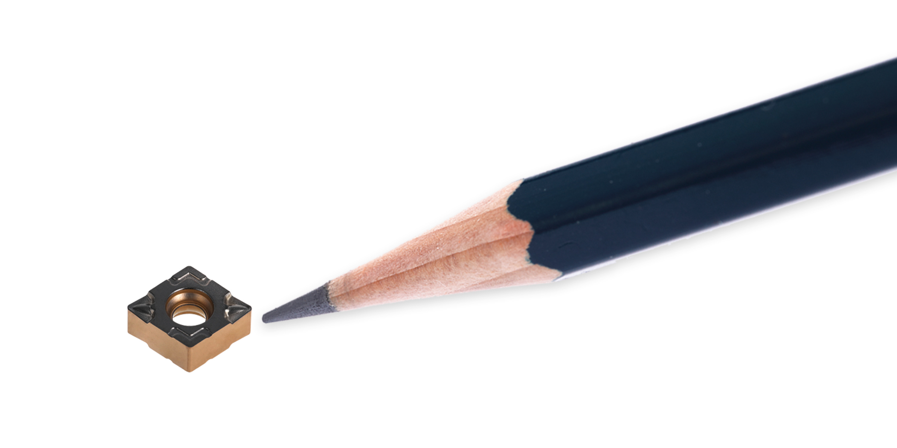

Ingersoll also targets smaller insert technology to reduce the tungsten content, he noted. This technology includes RhinoTurn inserts with a 25% smaller IC and the same thickness and top surface geometry as 12.7 mm (1⁄2") IC inserts, which achieve the same feed rates at a 20 to 30% lower price, and replaceable tip drills as small as 4 mm (0.157") in diameter.
Ingersoll Cutting Tools RhinoTurn insert
RhinoTurn inserts have a 25% smaller IC and the same thickness and top surface geometry as 12.7 mm (1⁄2") IC inserts. Credit: Ingersoll Cutting Tools

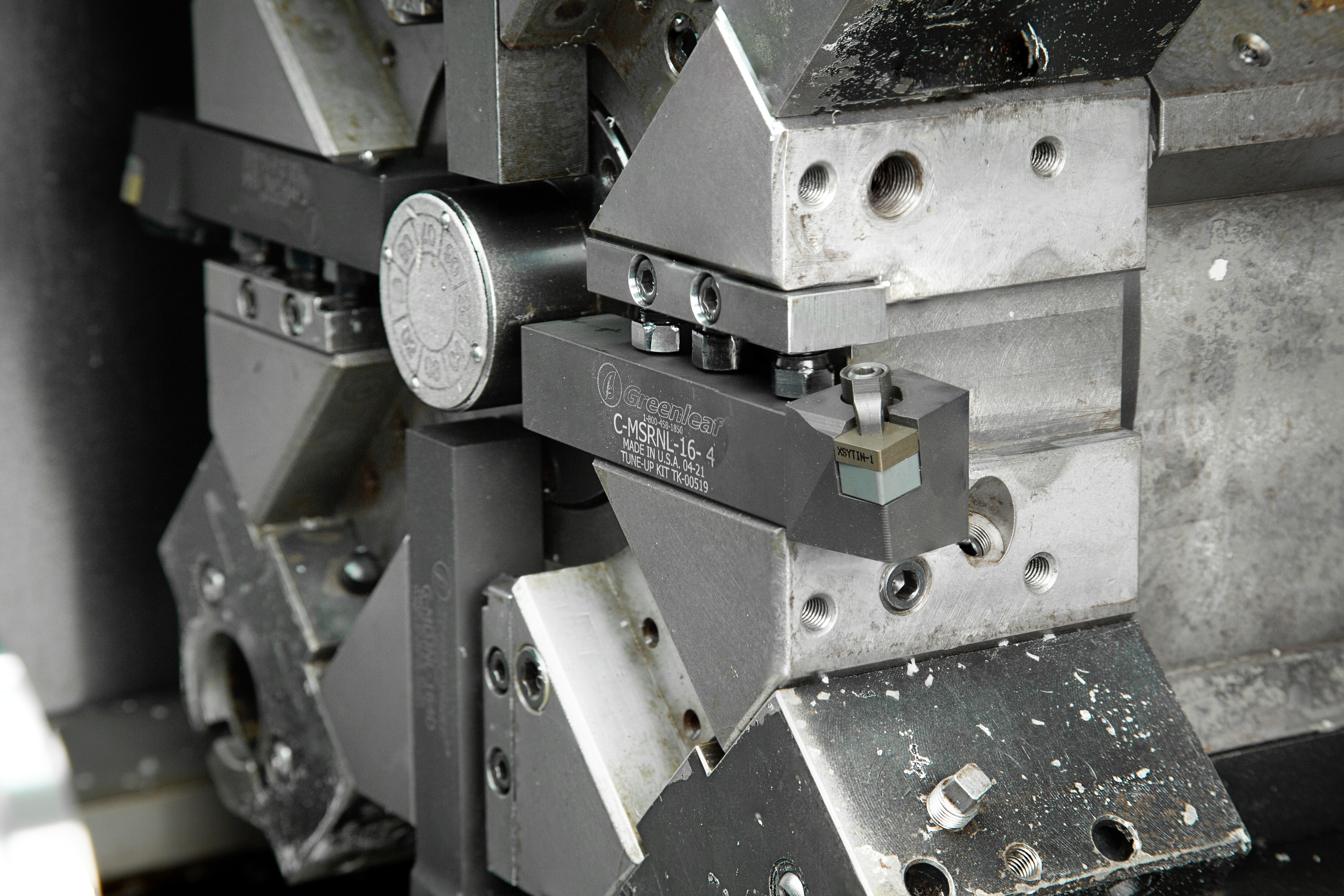

As the cost of carbide inserts rises along with the price of tungsten APT, end users can realize economic gains by switching to inserts made of alternate substrates, with one option being ceramic. In addition to offering carbide inserts in a variety of grades, Greenleaf Corp. in Saegertown, Pennsylvania, produces ceramic inserts, including ones made from its XSYTIN-1 grade, said Martin Dillaman, the toolmaker’s global manager, engineering/applications. Unlike carbide, the price of ceramic is stable.
XSYTIN-1 is phase-toughened ceramic with an interlocking grain structure grown during production, he added, noting that the grade has a different structure than the company’s traditional whisker-reinforced ceramics. The whiskers function like rebar to strengthen the ceramic and enable machining at high cutting speeds and silicon crystals to provide a tougher grade than general aluminum oxide ceramics.
Greenleaf XSYTIN-1 ceramic insert
XSYTIN-1 is phase-toughened ceramic with an interlocking grain structure grown during production. Credit: Greenleaf
“It kind of bridges the gap between some of those whisker ceramic applications and carbide,” he said. “That has been our go-to grade, especially for roughing operations, where it helps customers achieve much higher rates of material removal versus running with carbide.”
Carbide generally is run at a cutting speed from about 30.5 to 61 m/min. (100 to 200 sfm) when turning, whereas the ceramic grade can reach 305 m/min. (1,000 sfm), according to Dillaman. The speed increase is achieved while being able to feed at the same rate as carbide. Suitable applications for switching from carbide to ceramic include ones in which large inserts are applied to workpieces made of heat-resistant alloys, hardened steels and cast iron materials.
In operation, carbide inserts are designed with positive geometries, such as the rake angle, to shear the workpiece material, he explained, while ceramic inserts tend to be negative and generate heat as they compress and plasticize the material in the cutting zone and use the strength of ceramic to push it away, while extending tool life.
Dillaman said Greenleaf also provides CVD coatings for its ceramic inserts to enhance wear resistance and enable running at a higher speed — a double benefit when the application is appropriate. “We’re probably seeing almost an even split between coated and uncoated ceramics.”
Part manufacturers typically consider only finishing with carbide, but he noted that Greenleaf has the GF1 chip form for a positive ceramic insert to reduce the cutting pressure and enable the tool to be effective for finishing. “A CVD coating on that helps hold up that edge really well for the fine finishing operation.”
