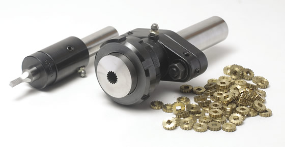

Broaching machines are available is many sizes; some are no bigger than a Bridgeport-type knee mill while others are the size of a small house. The size is determined by the power necessary to drive the broach, as well as the length of the broach and workpiece.
DSC_0050.tif
Internal squares and external splines are rotary-broached into small brass parts. Image courtesy Slater Tools.
