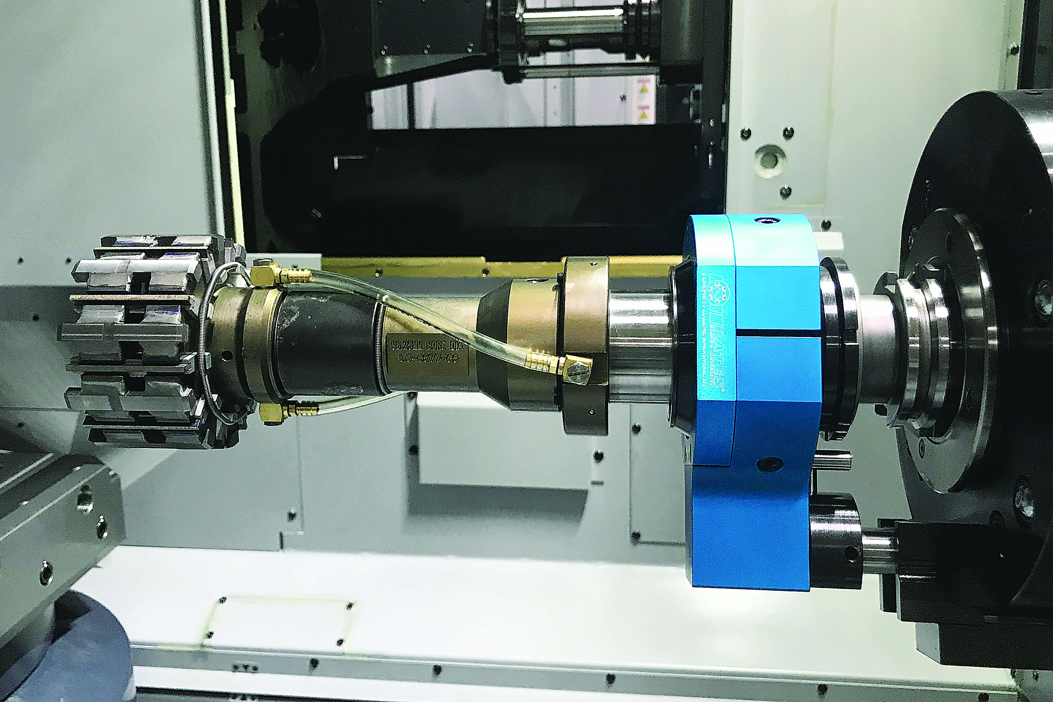

Being flexible is significant when the decision is made to hone on an HMC. “People really recognize the flexibility that comes with a horizontal machining center,” said Chief Technology Officer Douglas Watts for MAG Automotive LLC, Sterling Heights, Michigan. “So when you put honing on it, you are just incrementally more flexible in regards to the family of parts you can handle and the redeployment of the machine tool. Additionally, the use of several SPECHT CNC honing machines in a manufacturing system, rather than one large multiple-station traditional hone, results in a parallel process rather than a serial process. The parallel process will operate at a higher efficiency.”
The machine tool builder targets honing automotive applications, such as cylinder blocks and crank bores, on its SPECHT 600 HMC. “If you name any big European or U.S.-based automotive company, we’ve gone through some sort of validation process with them,” Watts said, adding that MAG has installed machines for honing in Europe and China.

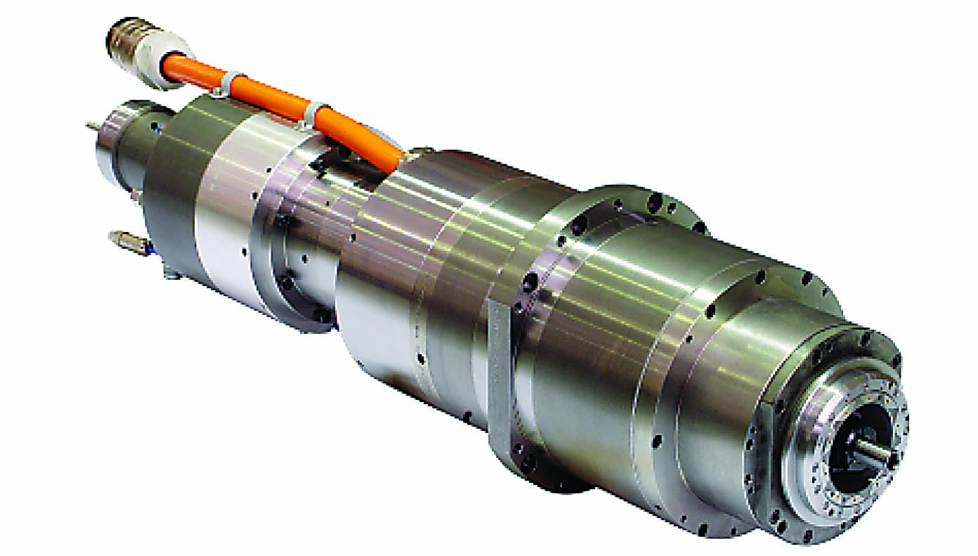

The integrated drawbar(shown as the orange cylindrical shaft extending out of the spindle) moves along the spindle centerline to create motion in the honing tool. Image courtesy of MAG Automotive
Several primary technologies are integrated into the standard machine to enable honing. The Z-axis linear motor allows fast acceleration to generate a specific crosshatch pattern in the cylinder bores, Watts said. It also eliminates the concern of having a ballscrew reciprocate repetitively, wear and require frequent replacement. “Now that it’s a linear motor, you don’t have anything to wear out from the drive mechanism point of view.”
In addition, he said MAG developed a suite of honing-specific software for the machine’s Siemens Sinumerik 840D SL control. The third technology is having a standard HSK 100 tool interface in the spindle, which allows the SPECHT 600 to function like a standard HMC when it is not honing.
Watts pointed out that the additional machine features needed for honing are a pneumatic transformer, a drawbar integrated into the spindle and a honing control cycle that is parameterized to simplify programming. This last feature avoids having to teach someone to program the machine to produce the required specific finish. Instead, the desired characteristics are entered and the control writes the program.
The pneumatic transformer turns a honing tool into an air gage as air from the tool’s air nozzle is pressurized back through the spindle and to the transformer. “This transformer allows us to confirm the size of the bore before we machine it, while we’re machining it and after we machine it,” he said.
A drawbar spindle with HSK 100 interface means that a U-axis runs through the spindle centerline and moves the drawbar along the centerline to create motion in the tool, Watts said. “That motion is used for expanding the honing stones. We also use it for the boring operations prior to honing. Because SPECHT machines use standard, rigid HSK 100 toolholders, other related machining operations can be combined with cylinder bore honing, leading to improved overall part quality for features like crank bores, transmission dowels, head decks and other critical features.”
