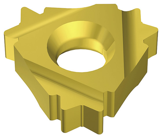

Groove milling tools are available as solid carbide, with a replaceable head (or insert) that screws on the end of the shank or with indexable inserts that fit into pockets on the tool body.
“We offer solid and insertable based on a diametric requirement,” Drape said. When groove milling a small ID, an insertable tool might not fit. “We typically switch to insertable at 10mm in diameter and up,” he said.
As the diameter increases, the cost of solid-carbide tools gets progressively larger, which is where inserts come in. “The problem you can potentially run into with an insertable tool is there is a fine line where the accuracy of an insertable cannot be as good as a solid,” Draped added. “Because you have replaceable components, you can’t maintain the same accuracy.”
When the diameter is large enough, Vargus’ Trimble indicated that indexable-insert groove mills are more economical. Say a solid-carbide tool costs $150 vs. $150 for a tool body and $25 for a replaceable head (insert) with three or six teeth. If the solid-carbide tool produces 1,000 grooves and the insertable tool produces 1,000 grooves, the solid-carbide tool will cost more over the long run because the user has to pay for a completely new tool once it’s worn. (Vargus doesn’t recommend resharpening.) For the insertable tool, he only has to pay $25 for each replacement head. Vargus offers Groovex solid-carbide and indexable-insert groove milling tools.
Whether solid or insertable, groove mills create simple linear and circumferential grooves—a square bottom or half-round groove such as for internal circlip or O-ring grooves.
Insertable tools are more flexible in terms of grades and geometries because the head or inserts can be changed. These tools are used for angled grooving, chamfering, parting off and generating gear teeth profiles, Woodruff keyways and T-slots, just to name a few applications.

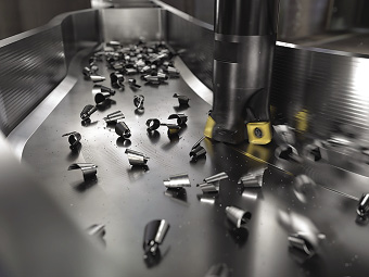

Chip evacuation is a concern in any metalcutting operation, but it is critical when grooving because chips are more prone to being trapped inside a groove and being recut. However, several tool design factors can aid chip evacuation when grooving.
Groove milling is an interrupted cutting operation, so the chips typically break into manageable sizes. Groove turning can produce long, stringy chips.
Iscar’s CHAMSLIT groove milling tool is an economical slitting tool but is used only for making shallow grooves. Courtesy of Iscar.
Courtesy of Iscar
Iscar’s CHAMSLIT groove milling tool is an economical slitting tool but is used only for making shallow grooves, according to Iscar. It can produce a groove up to about 1/8 " deep and from 0.047 " to 0.158 " wide. It can produce internal and external grooves.
A staggered-tooth, or half-effective, cutter design helps break chips. “In the case of our slotting cutters, we have opposing, or half-effective, cutters,” Schmitz said. “So if you have 10 inserts in the cutter, only five are effective. One insert cuts the top side of the groove while the insert behind it cuts the bottom (or opposing) wall, which helps with chipbreaking. It also produces a narrower chip than what would be produced with a single wide insert, enhancing chip evacuation.”
Generally, a cutting edge on a slotting cutter is oriented at 90° to the slot wall. The angle of the cut sends the chip into the sidewall.
Iscar’s tools feature the cutting edge orientated at a different angle. “It is not 90° to the slot,” said Hassan Naraimhan, national product manager for indexable milling cutters at Iscar. “It could be 70° or 60°, so that deflects the chip from the slot surface so it doesn’t damage it. The angle actually draws the chip away from the slot wall.”
Also, most groove mills have through-coolant capability for chip flushing.
