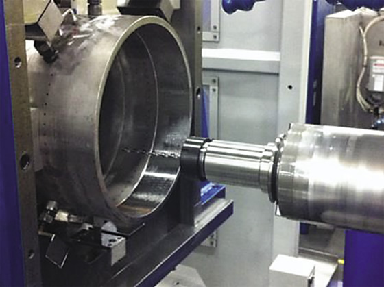

deepholedrill.tif
Courtesy of All images: C. Tate
A 6mm (0.236 ") drill produces a hole 20 diameters deep on a horizontal boring mill. Mitsubishi Hitachi Power Systems Americas typically performs deep-hole drilling in the horizontal position to aid chip evacuation.

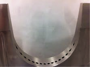

turbine.tif
The holes in this turbine component are 2.4mm (0.095 ") in diameter and 55mm (2.16 ") deep, about 20 diameters deep. Deep-hole drilling eliminates the need for a secondary process, such as EDMing.
