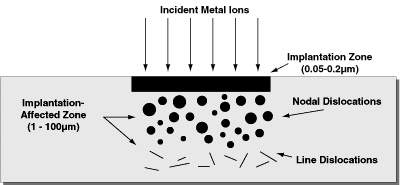

A second theory suggests that ion implantation induces or otherwise causes the formation of a dislocation network structure in the material, and it is this structure that suppresses both crack formation and crack propagation (Figure 4). A number of studies support this theory.
Eye on Ions
Figure 4: Ion implantation produces an implanted zone, where the ions settle, and an implantation-affected zone, where the mechanical effects of ion bombardment cause changes in the material’s morphology, stress, and chemistry.
In one study, researchers measured dislocation densities following metal ion implantation and found these to be much greater than densities seen in unimplanted materials. Structural changes extended 20µm below the surface, and evidence of changes in dislocation density was found down to 100µm or more.
Others have reported modifications to many physical properties brought on by the dislocation structure after ion implantation, including changes in the material’s hardness, wear resistance, and phase structure. It is believed that the higher hardness (which is proportional to the dislocation density) leads to higher abrasive wear resistance and that any increase in compressive stress that may result from ion implantation increases the fatigue-wear resistance.
Using the second theory to explain the results observed in the laboratory with the Al2O3-coated inserts, it might be said that the ion implantation caused a change in the dislocation structure of the coating and, possibly, in the carbide substrate as well. This led to increased wear resistance and, thus, to the observed improvements in tool life.
