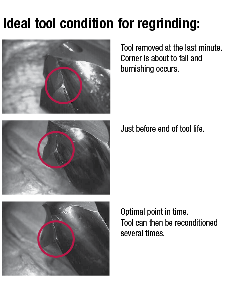

Shop personnel must also be trained to watch for increasing burr size, poor surface finish and dimensional changes, all signs of worn tools. Being able to identify cratering, plastic deformation, flank wear and other wear patterns enables the operator to intervene and make adjustments that prolong tool life.
Rely on guidance from the toolmaker to develop a training program—often free of charge—so shop personnel can learn to recognize the signs of worn tools and properly determine wear patterns. A robust training program allows personnel to correctly determine the proper time for removing a tool from service, which not only prevents costly tool and part damage but also premature tool removal (see graphic below).
Reconditioned tools should perform as well as new tools. If there is a performance drop after reconditioning, it may be time to look for a different vendor. Even a large savings in the reconditioning cost per tool can be eclipsed by the cost of lost productivity from an improperly reconditioned tool. Shop personnel often avoid using reconditioned tools that perform poorly, defeating the purpose of reconditioning.
