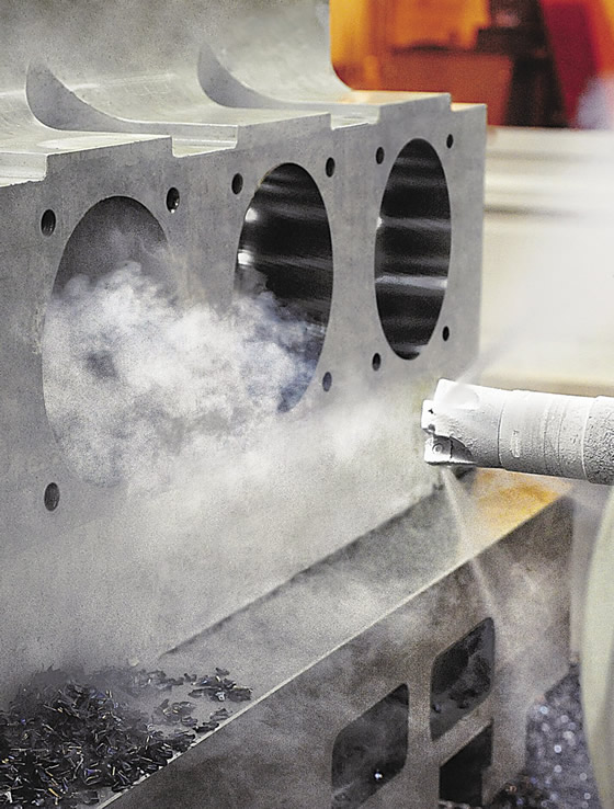

At -321° F (-196° C), nitrogen is an effective, residue-free cryogen for combatting a cutting tool substrate’s worst enemy—heat. “If you don’t efficiently remove the heat, the result is thermal softening of the cutting tool and tool failure,” said Rana Ghosh, applications R&D manager for industrial gases at Air Products and Chemicals Inc. The Allentown, Pa., supplier of industrial gases developed the ICEFLY cryogen-delivery system and associated machining know-how to apply a cryogen at the cutting zone. The technology, which the company licenses, maintains a temperature from -250° F to 32° F (-157° to 0° C).
The system uses a proprietary coaxial, or tube-in-tube, geometry to flow high-pressure LN2 through the inner line and a low-pressure stream of LN2 through the outer line to minimize heat loss in the inner tube, Ghosh noted. The saturated, high-pressure LN2 stream is jetted through an external nozzle and immediately evaporates after impinging on the target surface, without leaving any residue.
5ME-1314-3341635317-Outline.tif
According to 5ME, Lockheed Martin machined a medium-sized titanium (Ti6Al4V) aerospace structural component 52 percent faster with 5ME’s cryogenic machining technology than with coolant.

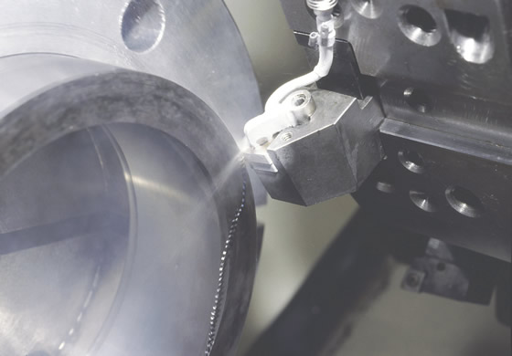

ICEFLY_horizontal.tif
The ICEFLY cryogen-delivery system delivers nitrogen gas to cool the cutting edge.
One such nozzle, which can be retrofitted to virtually any vertical or horizontal machining center, is the Spidercool servodriven, programmable nozzle from Dimensional Control Inc., said Rick Knopf, owner of ICEFLY-licensee Industrial Cryogenic Technologies LLC, Macungie, Pa. The standard Spidercool, however, was redesigned with some new internal components to operate at such low temperatures without binding.
Ghosh noted ICEFLY is primarily targeted at five application areas: steel and iron harder than 45 HRC; sinter-hardened or heat-treated powdered metals; hard metal-matrix composites; cobalt chrome and other difficult materials for medical implants to avoid the use of traditional metalcutting fluids (long suspected as a source of contamination); and implants made of polymers, such as silicone, polyurethane and PEEK (polyether ether ketone).

To quantify the technology’s productivity when cutting metal, Judge noted an application at Lockheed Martin in which a medium-sized titanium (Ti6Al4V) aerospace structural component was machined 52 percent faster with 5ME’s cryogenic machining technology than with coolant (see photo on page 51). In addition to reducing cycle times, the LN2 process improves surface integrity and part quality by reducing residual stress, burr formation, grain boundary distortion and white, or martensitic, layer production during machining, according to company test results.
“All of those are just value-added benefits above and beyond being able to machine parts much faster and with less cost, as well as the green aspects for improved operator health and safety with the elimination of cutting fluids,” he said.

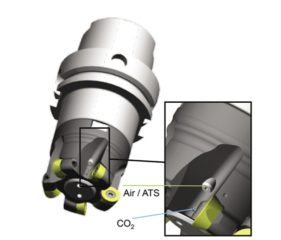

Liquid nitrogen isn’t the only cryogen in town. At -78.5° C (-109.3° F), liquid CO2 seems balmy compared to the frigidity of LN2, but it is effective at holding a cutting tool at ambient temperature to extend tool life and boost productivity while imparting finer finishes compared to noncryogenic approaches, according to Kevin Maples, RCC (regional competence center) Americas – aerospace and energy for Walter USA LLC, Waukesha, Wis.

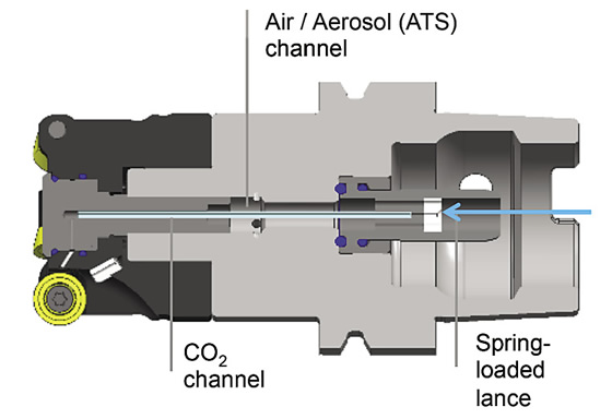

Vikki Franke, project manager for cryogenic tooling in the R&D department at Walter AG, Tübingen, Germany, explained that CO2 is transported in a liquid phase at room temperature to the tool exit, where it expands into a gas and the low temperature occurs.
The manufacturer of precision tools developed Cryo·tec cutters for cryogenic machining (see diagrams on page 54). It teamed with the Starrag Group to demonstrate the CO2 cooling system in machine tools from the Switzerland-based builder, which offers retrofit services for its equipment. The retrofit includes exchanging the machine spindle.
“Technically, it’s not a problem to provide this technology for every existing Starrag machine on the market today,” said Michael Schedler, marketing manager for Starrag. (Starrag USA Inc. is located in Hebron, Ky.)
However, he noted Starrag is primarily targeting the system at one application: simultaneous 5-axis machining of blisks and blades, such as turbine blades, made of difficult-to-machine materials.
Unlike through-spindle, through-tool LN2 systems, the Starrag/Walter arrangement offers two channels: one for CO2 and one for air or an aerosol-based dry lubricant. This enables an end user to apply CO2-cooled aerosol, CO2 and air, just aerosol, just air or just CO2. When machining titanium, for example, Franke pointed out that some lubrication is needed to reduce friction.
She added that when air alone won’t do the trick, CO2 can be added, balancing the two for machining effectiveness and economy. “You try to use as little CO2 as necessary,” she said.
The tool bodies, which reportedly have an optimized diameter and cryogenic cooling channel, are specials, but accept standard indexable inserts, Franke noted.
