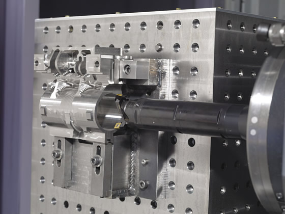

The rigidity of the T2 5-axis machining center enables Patriot Machine Inc., St. Charles, Mo., to apply long tools and pursue complex machining processes when cutting titanium, according to Makino.

On big inserted cutters, users are limited to the machine structure’s ability to dampen the energy from the cut. However, with endmills, it is possible to improve the system’s damping characteristics by using a milling chuck or collet system. These systems have many different pieces, and the interface between each piece creates a place for friction to dampen the vibration. The opposite occurs with a shrink-fit toolholder. Because a shrink-fit holder is one piece, it tends to act like a tuning fork, vibrating for a long time from the impact of machining.
