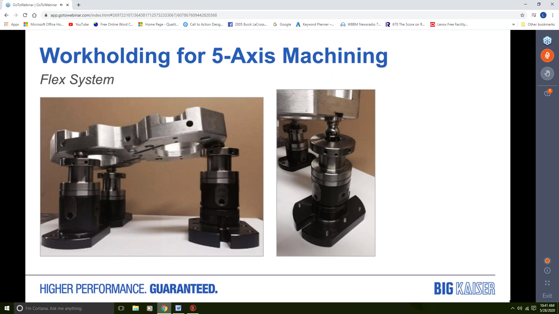

John Zaya, Unilock product manager, discussed workholding products, including for 5-axis machining that “allows users to stack and reconfigure the system as needed for your requirements.”
Zaya along with Cetkovic conducted a technical presentation on 5-axis machining that was moderated by Jack Burley, vice president of sales.
“Major decisions about workpieces and machine selections as well as CAM software are all very influential to the overall productivity of 5-axis machining,” said Burley. Zaya discussed the different types of 5-axis machines and suggested better workholding options, and Cetkovic detailed trends in cutting tools and tool holders for 5-axis applications.
Five-axis machining can present machining challenges. For instance, a workpiece might be too far from the tooling leading some customers to use longer toolholders or cutting tools, but these solutions might lead to lower feeds and speeds, lower depths of cuts, and chatter-prone cutting operations. Part tilting can be a problem if too-tall of jaws are used.
One solution, according to Zaya, might be Unilock products that elevate workpieces.

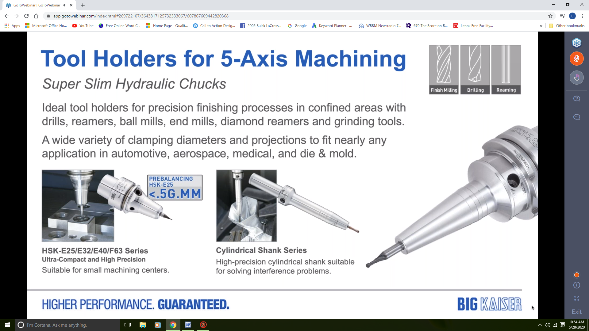

Cetkovic discussed toolholder solutions including shrink fit holders and hydraulic chucks. One product highlighted was the Super Slim Hydraulic Chucks for precision finishing processes that “eliminates interference and is ideal for high precision 5-axis machining,” he said.
