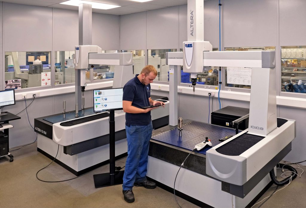

New AlteraS CMM at WLR Precision Engineering
WLR Precision Engineering is a contract machining specialist in Wilford, Nottinghamshire, and the company was using a pair of 15-year-old coordinate measuring machines (CMMs) in its inspection room. Looking to upgrade the technology, WLR Precision invested in two CMMs manufactured by LK Metrology. Soon, they had largely superseded the older CMMs.
The machines have been supplied with the LK Launchpad, an icon-driven, touch-screen operator menu, and a network of viewing screens and tablets. Production operators and the quality inspectors who operate the CMMs are provided with easy access to measurement reports as part of the operator menu.
The operator’s menu lists available inspection programs, and the exact part position on the machine table for inspection, giving operators the ability to perform measurement tasks in just a few clicks. It enhances flexibility and opens the system for use by non-specialist CMM operators. Measured results and automatically generated reports may be shared between screens, tablets and other networked devices for easy access and viewing from any location.

By May 2021, a requirement was also introduced for in-process inspection of a particular family of components for one customer. This time a smaller LK AlteraS 10.10.8 with a working volume of 1,016 x 1,016 x 813 mm was purchased, together with the latest CAMIO 2021 and the additional LK Launchpad software. The unit allows for parts to be loaded singly or in batches of up to six at a time.
Launchpad makes it simple to load the correct program for inspecting a component, which is easily identified from stored data, with details called up via simple graphical menus and icons on a screen positioned by the machine.
The operator can locate the component by selecting the customer by name, via the part category, or by directly calling up the part itself complete with details of the machining process. Set-up on the CMM is straightforward, assisted by 12 mm thick aluminum fixture plates pre-drilled with a grid of holes at a 50 mm pitch fitted across the granite table of the machine. The operator simply places the component in a numbered location on one of the fixture plates, as indicated by the Launchpad graphic, and instigates the measuring program by pressing a button on the touchscreen. Despite being a powerful process, WLR confirms that the software is remarkably flexible and easy to use.
For convenience, the same inspection results that appear on the screen adjacent to the machine are also available on networked tablets used by machinists on the shop floor and the information may also be shared with other devices. It enables more robust inspection and less downtime as well as creating an environment where machinists become invested in the procedure. The next step will be to include functionality that allows operators to be alerted via their tablet when the measuring cycle is complete, so there will be no need for the person to keep an eye on the time.
Pre-drilled location plates are a feature on the granite of the larger LK CMM as well, assisting loading of components in batches or individually on that machine too before the inspection. Launchpad software is also used, so both machines may be employed for either batch inspection or for operation inspection by shop floor staff, further increasing the efficiency of the quality control department.
