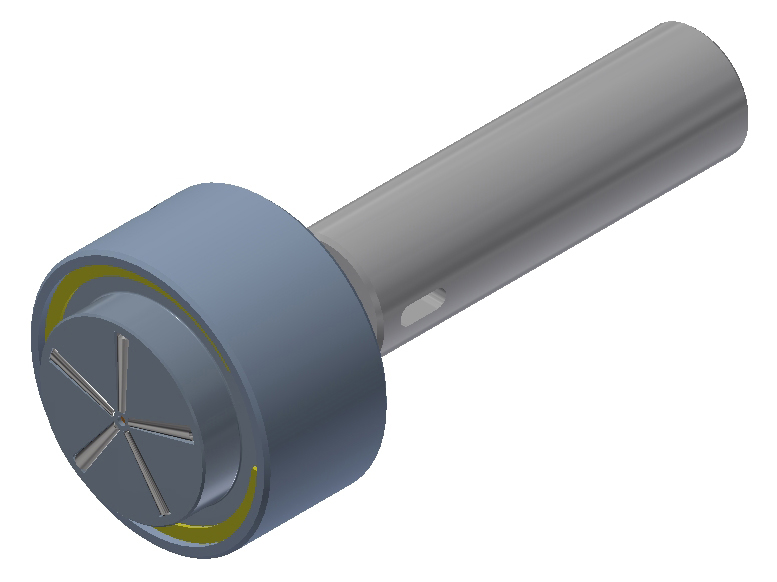

Flat face tool for ventilator part
Dayton, OH – Custom tooling requests are not unusual at Monaghan Tooling Group, and each gets special attention.  They are all important. However, when it’s a life-or-death situation, you tend to pull out all the stops.  That’s exactly the situation that the MTG team faced when they received a request for a burnishing tool to produce a very fine micro-finish on a flat surface of a ventilator component.  New England’s Butler Bros., a Monaghan distributor, had a customer that needed custom tooling to produce 2500 ventilator components a week by mid-April.  The team turned the project around – from purchase order to signed approval print for custom tooling in 5 hours and 15 minutes.  While that breakneck is not the norm, Monaghan and their Elliott Tool Technologies partners were committed to help speed the production of critical ventilators to COVID-19 patients nationwide.
“As soon as we heard ‘ventilator’ we made this our #1 priority” said Monaghan Tooling Group president Scott Monaghan.  Despite the urgency of the request, it was still critical to work within processes at MTG and ETT to ensure that the project was complete with utmost accuracy and speed.
After review of the application, MTG engineers determined that a custom designed flat-face multi-roller burnishing tool would produce the desired surface finish.  Following some emails and phone conversations with their distributor Butler Brothers, whose customer presented the urgent need, the decision was made to move forward and place the order.

Why Multi-Roller Burnishing Is Ideal for This Application
Multi-roller burnishing is ideal for this application because it achieves the desired surface finish without secondary processes like grinding, honing and polishing and the inherent time required for these additional set-ups.  It produces a 4 to 8 Rs surface finish in one pass, making it a faster process than multi-pass approaches.  This repeatable and consistent process improves surface irregularities and tool marks.
Additionally, burnishing increases the surface hardness through the cold working process and compressive forces.
This aluminum component is being machined on a drill press, so achieving the 15 Ra finish is ideally suited for multi-roller burnishing.
