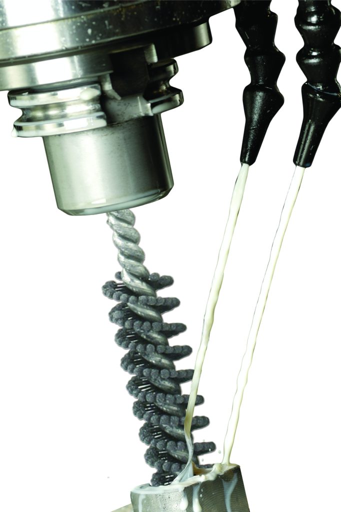

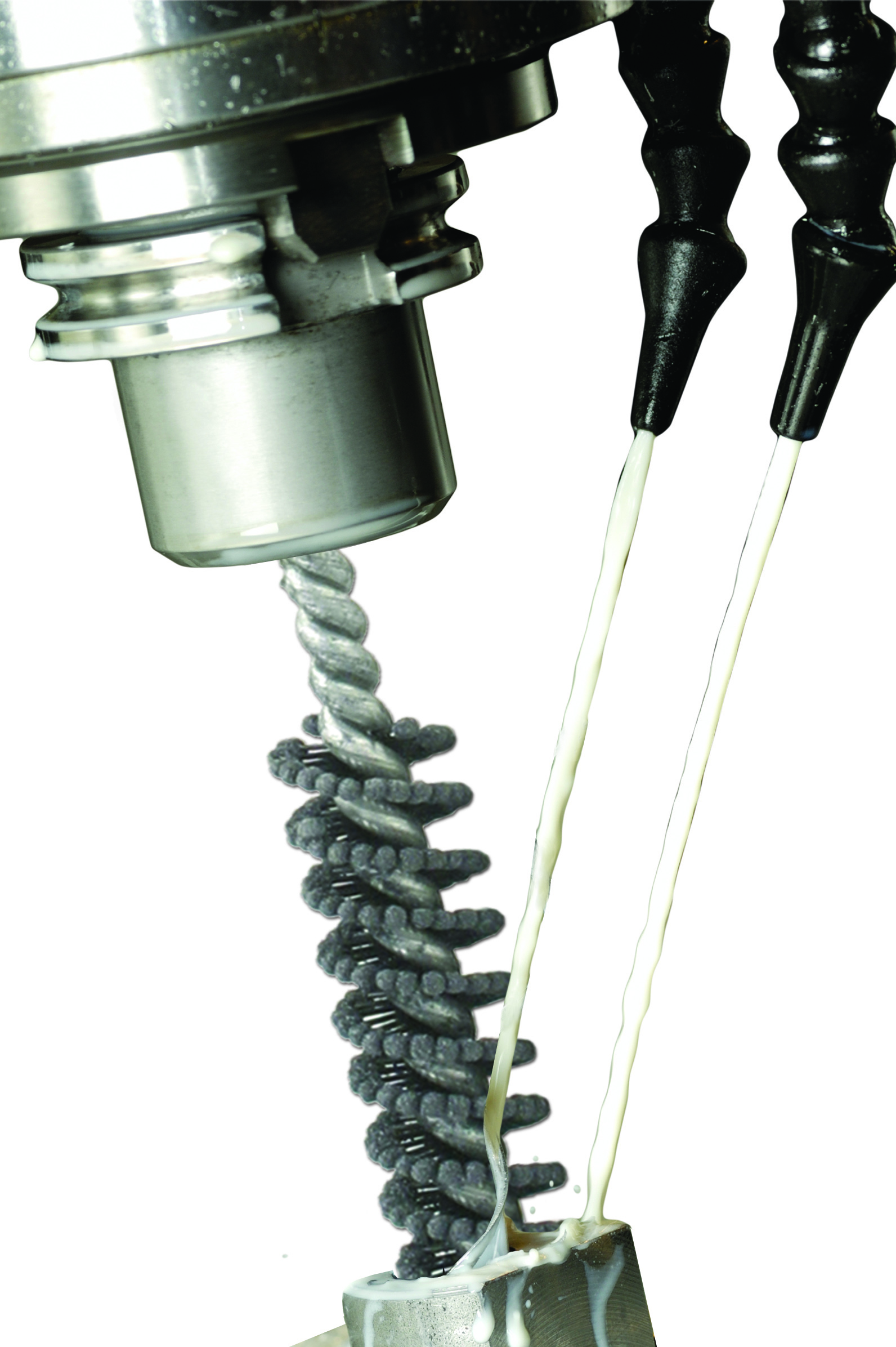

Flex-Hone feature permanently mounted flexible filaments.With new advances in abrasive technology, machining center operators are able to complete surface finishing simultaneously with other machining operations, to speed cycle times, improve quality and save on off-line finishing time and costs. The abrasive finishing tools can be easily integrated into CNC machines carousels or tool holding systems.
While contract machine shops are increasingly turning to these tools, others worry about the use of abrasive materials in expensive CNC machining centers.  The concern is often a generalized impression that “abrasives” – like sandpaper – release large amounts of grit and debris that could clog coolant lines or damage exposed slides or bearings. These concerns are largely unfounded.

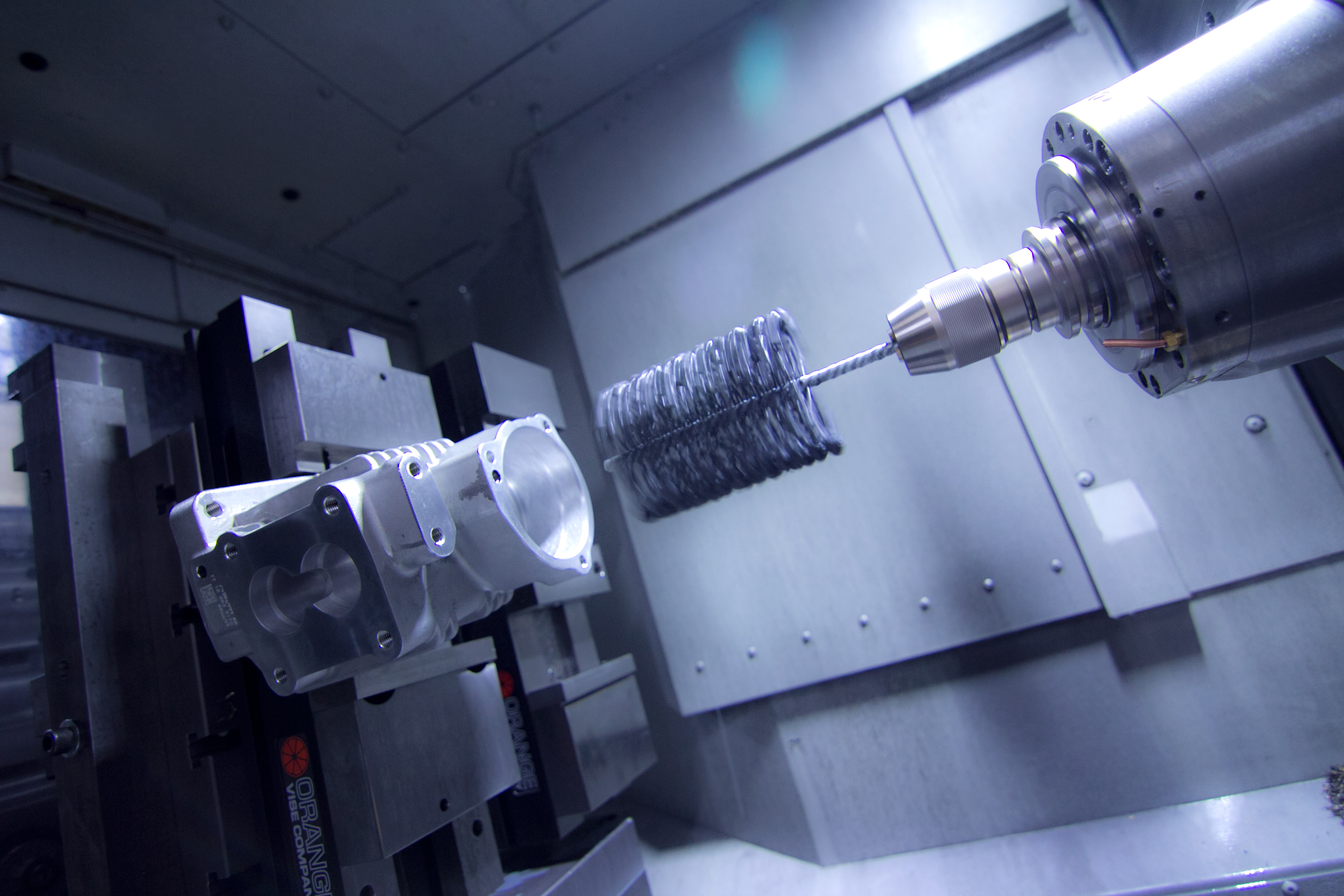

For the past eight years, Wolfram Manufacturing has incorporated the Flex-Hone in all CNC machines for cross-hole deburring and surface finishing.  The Flex-Hone from Los Angeles-based Brush Research Manufacturing (BRM) is characterized by the small, abrasive globules that are permanently mounted to flexible filaments, the product is a flexible, low cost tool utilized for sophisticated surfacing, deburring and edge-blending.
Removal of burrs and sharp edges in cross-drilled holes and other difficult-to-access areas such as undercuts, grooves, slots, or internal holes is critical.  Failing to remove burrs can cause blockages or create turbulence in the flow of fluids, lubricants and gases through critical passages.
“On a given part, we might deploy two to three different size Flex-Hones, depending on the number of cross port intersections and different hole sizes,” explains Urano.
The Flex-Hones are added to the tool carousel and are used daily, usually several times an hour, on some of the shop’s highest volume parts.
“The volume of abrasives that could even possibly come off of the Flex-Hone is insignificant compared to the rest of the particulate that gets into the coolant,” explains Urano.

According to Sun, many of the vises are made of cast iron with selectively hardened surfaces.  To match the surface finish of the hardened surfaces, Orange Vise uses NamPower abrasive disc brushes from Brush Research.
Composed of flexible abrasive nylon filaments bonded to a fiber reinforced thermoplastic base, the NamPower abrasive disc brushes contain a unique combination of both ceramic and silicon carbide abrasive.  The abrasive filaments work like flexible files, conforming to part contours, wiping and filing across part edges and surfaces to deliver maximum burr removal rates along with an ideal surface finish.  Other common uses are edge blending, part cleaning, and rust removal.
To complete the surface finishing operation, abrasive nylon brushes are installed in the tool loading system of each CNC machine.  Although abrasive grit is involved, Sun says the NamPower brush is a “different type of abrasive” because it is essentially “self-sharpening.” Because of its linear construction, sharp new grains constantly come in contact with the work surface and wear off exposing fresh cutting particles.
“We have used the NamPower abrasive nylon brushes daily for six years.  During that time, we have had no issues with any sort of particulate or grit getting into any critical surfaces,” adds Sun.  “In our experience, any small amount of grit created is a non-issue.”
